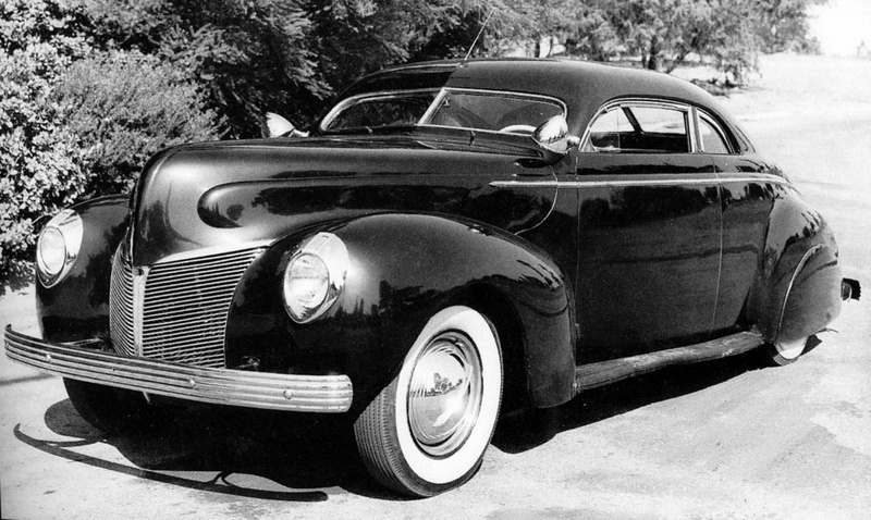

1940 Mercury restyled by Barris Kustoms for Johnny Zaro of Maywood, California. After being discharged from the Navy in 1947, Johnny and his buddy Al Andril decided to buy a pair of 1940 Mercury's. Al lived across the street from Johnny in Maywood, and they were good friends. "Al and I knew each other since we were 10 years old. He moved from San Francisco. We went in the Navy together, and when we got out, we decided we were going to get '40 Mercs and customize them."[1] During their conversations about the coupes, they decided to have the tops chopped. They choose Barris Kustoms to perform the job.[2] In 2011 Justin Kudolla interviewed Johnny about the car for a story in Trend Book 208 Custom Cars 2012 Annual. Justin asked Johnny how he found out about the Barris Brothers. Johnny said that Al must have found out about them. "I didn't know where they were at. We were both down in San Pedro waiting to get discharged and he found the place up there then." The year was 1948, and George and Sam had now moved to larger premisses at 7674 Compton Avenue in Los Angeles. George and Sam talked the two kids into a lot of modifications, including shaved handles and molded fenders. Al's coupe was restyled first. "Mine was a bigger project" did Johnny tell Justin. "Because when I was coming down Alameda, there was a car that pulled into the side of me."[1] Johnny's Merc was mildly restyled when he wrecked it. Modifications included a shaved hood and decklid, shortened side trim, and single bar flipper hubcaps. The accident happened the day Johnny was driving the car up to George's. "The day I got discharged out of the Navy I was driving mine up to George's and a car reversed into the side of me and pushed me into another car."[3] Johnny was still living at home when he crashed the Merc. Sam was in the shop working late the night of the accident, so Johnny called him and said "I smashed my car up, and I haven't gotten home yet.." Sam gave Johnny a ride to his house at 4 in the morning.[1] They had to cut the whole section out on the passenger side; the fender, everything had to go." Barris Kustom Techniques of the 50's - Volume 3 shows a photo of Johnny's smashed up Merc outside Barris' 7674 Compton Avenue shop in Los Angeles. When the photo was taken, Al's coupe had just been chopped. "Sam went ahead and started on Al's and as soon as he got Al's primered, he started on mine." It took Sam about nine months to do the work on Al's car. The experience gained allowed him to complete Johnny's Merc in only six, despite all the repair work necessary. According to Johnny, it was Sam who did the work on his Mercury. Since Johnny had piled the Merc up before Sam started working on it, Sam had to cut the whole side out of the car and do the repairs.[3]

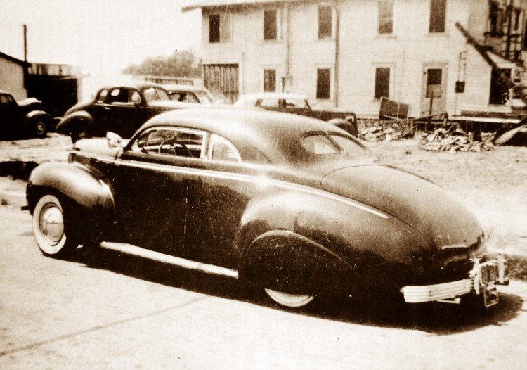

Every time Johnny and Al had a chance, they would get out and go up to Barris Kustoms and work on the cars. "See, when you had George work on your car in those days, it wasn't going to be done unless you got down there and worked on it too. Most of it was easy work, like sanding or some little thing, they did all the major work, believe me. It was at nighttime a lot of times. We couldn't get up there in the daytime. Sometimes George would be there until 12 or 1 am, something like that, if he was spraying something. But as far as bodywork, he would get done at maybe 5 or 6 o' clock. And when I knew George he was living in nothing but a garage with a dirt floor and a little bathroom in Huntington Park. And from there, he got a step up; he started living in Warren Breeland's mother's home over near the shop. Warren, he was going to UCLA. I don't know where George lived when he had the shop in Bell."[1]

At Barris Kustoms the door handles were removed, and substituted by electric push-buttons. The fenders were molded to the body with an elegant curve on the rear fenders. The top was chopped 5 1/2 inches, and the body was channeled over the frame. Small round motorcycle taillight units were set on either side of the bumper guards. The bumpers were 1938 DeSoto ripple bumpers, and the skirts were steel teardrop units. Up front, the Merc was lowered using a Dago dropped axle. Overall height of the car was 4' 11". Ground clearance was 4 inches in the rear.[4] The body was covered in several layers of deep Maroon lacquer. Single bar Flipper Hubcaps on wide whites and Appleton spots wrapped up the style.[4] [2]
