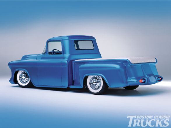

![1955 Chevy Pick up - Star Dust - Justin Hartman - Star Kustom Shop 1207cc10](https://i.servimg.com/u/f39/17/91/41/66/1207cc10.jpg)
If various aspects of this ’55 Chevy truck seem familiar, well, it’s no coincidence. Over the past few months there have been a handful of stories on the pages of CCT on building Star Kustom Shop’s newest project, “Stardust.” As mentioned through the stories, Stardust is a throwback to the golden era of customizing, mixed with fresh ideas and a blend of modern-day tastes. But before we get too in depth about the truck, let’s go back to the beginning and see how this custom came to fruition.
