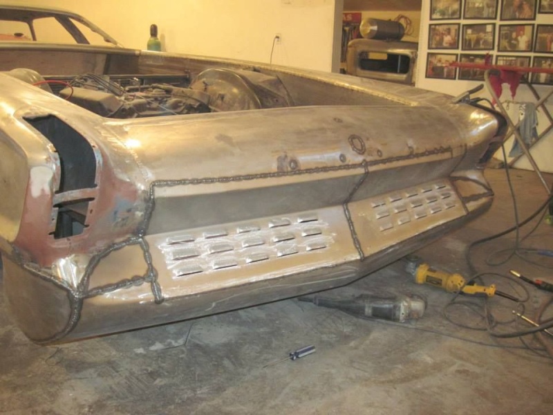

Of course, in the tradition of radical customizers, there isn’t much left of the Chrysler that he got for free last July, a four-door sedan that had been stripped for parts for use in the restoration of another car. No drivetrain, no interior, hardly any suspension or glass to speak of, and plenty of rust chewing through what was left. “I just didn’t know what to do with the car after I got it,” he said. It wasn’t until he spied the roof on a 1974 Oldsmobile Cutlass two-door he already owned that inspiration struck – he’d plop the Cutlass roof on the Newport’s body, but not where most people would put it. And for good measure, he’d power the thing with a Cadillac Eldorado front-wheel-drive power unit, but again, not where most people would put it.

So he started by cutting off the roofs of the Newport and the Cutlass and welding the Newport’s doors shut and fenders to the body, then positioning the Cutlass’s Colonnade roof over the Newport’s former engine bay. In the process, he cut away the Newport’s cowl, rear bulkhead, floor, and much of its trunk lid.

He eventually ditched the Newport’s frame altogether for a custom frame built from two-inch-by-four-inch box steel, connected to the partial frame that the Eldorado V-8 and driveline came on, positioned to get the wheels to line up with the Newport’s wheelwells.

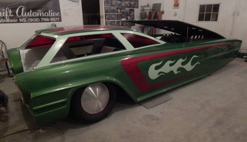

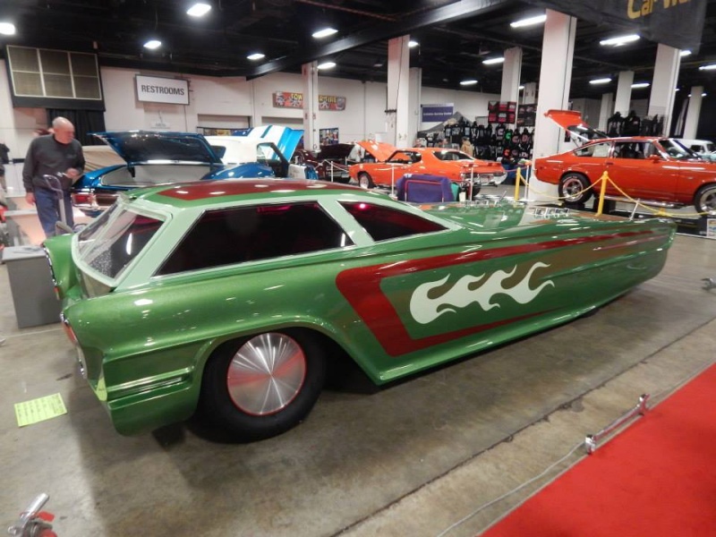

When we last left Chad Hiltz and his Green Goblin cab-forward custom 1962 Chrysler Newport, it wore a coat of primer, but Chad had yet to iron out a number of details – like exactly how the door would hinge up, the paint, and whether he would make it to the Boston World of Wheels show as planned. From the looks of things, though, Chad has managed to pull it all together in just the nick of time.
From perusing Chad’s Facebook page, we see that he did indeed paint the Green Goblin a pearlescent green with Hot Wheels-inspired metalflake silver interior and engine bay/bed.
![Green Goblin - Chad Hiltz. Greeng23](https://i.servimg.com/u/f38/17/91/41/66/greeng23.jpg)
As one would expect for a radical custom, though, Chad didn’t stop there. Metalflake red scallops now tear down the flanks and roof of the Goblin, and a lighter green highlights the roof pillars and zoomie openings. He also molded some red-tinted acrylic (in his oven) for at least the side windows, and went with a simple black-and-white scheme for the custom-built and upholstered seat. Moon caps on the wheels are understated, yes, but fit the Goblin nicely.
![Green Goblin - Chad Hiltz. Greeng24](https://i.servimg.com/u/f38/17/91/41/66/greeng24.jpg)
Oh, and before spraying the paint, he reworked the nose to do away with the beak and the Mercury grille inserts.
There still appear to be a few details to attend to, but Chad has a truck and trailer lined up to take the Goblin to Boston for this weekend’s show nevertheless.

Owner of Green Goblin Customs, he recently won three awards at the World of Wheels, an international car show held in Boston. A television crew from Germany flew over to film his excursion to the U.S. car show.
Prior to that he took home four awards at a speed sport show in Moncton.
So why all the fuss?
The Green Goblin, his latest car, which won the master builder’s award and placed first for radical custom, was a 1962 four-door Chrysler given to him as junk.
