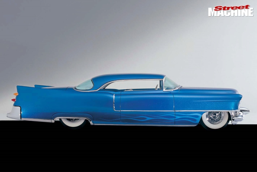

It takes a fair degree of confidence to gas axe such a revered car – roof chops look either trick or shit. However, Orange, NSW-based hot rodder Ron Zelukovic, the metal master behind the preliminary work on Daryl McBeth’s two-door Magna, made the four-inch chop look a treat. To do this Ron carefully pie-cut, relieved and added countless pieces before hammer-welding it all back together to create its new flowing line. Following this was the equally difficult task of recontouring all the interior and exterior moulds before Allan McCoy gave them a mirror finish.
Making the shortened front screen was a huge job. Firstly Daryl from Windscreens on the Move (NSW) used the original screen to make a buck of the required shape, from this Stuart Jamieson from Perfect Glass (Qld) then made a stainless steel mould – such work costs around $3000.
“It was the biggest headache of the car, but they did a perfect job,” Mario says. The rear window is actually stock but has been laid forward and sunken down into the rear parcel shelf and is urethaned in.
With the chop successfully completed, the ’55 was shipped to Zelukovic Smash Repairs (another Orange-based business run by Ron’s brother John along with John’s son Ben) where the prominent tail fins and bullet taillights from the later ’59 Caddy were added. The fins were formed by rolling sheet metal over a fabricated skeleton. Super-fussy Mario wasn’t 100 per cent satisfied with the shape of the first set, so had the boys knock up a second set – lots of work but well worth the effort.
Ben tells us the rats had done so much damage to the floor while it was sitting in Colin’s yard, they nicknamed it Rat Cad.
“The floor was two inches thick with apricot seeds, leaves and rat shit and was completely rusted out,” he laughs. “We fabricated a complete new floor pan.”
That done, the bonnet was then shaved to give it a lower, flatter appearance, and gas struts were installed to prop it open. Underneath a one-off apron panel extends from the top of the grille back to the radiator. “We stripped all the junky stuff like the heater box and wiper motor off the firewall and basically threw it over our shoulder,” Ben says.
Although it was a huge job, removing the flipper or quarter-vent window gives the Caddy’s profile a much cleaner look. Mario, son Andy and Silvano Agazzi spent six months modifying the bailey channels and factory power mechanisms to accept the one-piece glass – supplied by John from Liverpool Glass.

Low is cool and there was never any doubt King Cad was going to be bagged. In preparation John Agazzi rebuilt the chassis before C-notching the rear and raising the driveshaft tunnel to gain adequate diff and tailshaft clearance to sit the car on the deck. Fitting the AirRide bags and shortening the bump stops was enough to adequately drop the front, while Terry Cartwright added Commodore power rack and pinion steering to give the Caddy improved road manners. Finishing off the chassis are those period perfect, 29-inch tall L78/15 Corker Classics supplied by Antique Tyres in Melbourne.
Those huge grille bullets are the ’55’s trademark and to further accentuate them the horizontal centre bar was pulled back an inch. At either side, the original blinkers have been replaced with Moon bullets with LED blinkers now located at the upper corners of the laser-cut billet grille.
In its day, few small-blocks outgrunted the ’55 Caddy’s original 331 cuber. Seeing that it was always intended to be a fun custom driver, Mario saw no reason to change things with John Agazzi bringing the factory mill back up to as-new condition – right down to its signature Cadillac rocker covers. Similar story with the rest of the driveline with John giving the factory four-speed auto the same good tart up as the LSD.
Mario loved the bullet gauges from the ’59 Chevy and its RHD configuration meant Wayne Colquhoun, who did the right-hook conversion, had less drama. The dash was heavily massaged and rechromed before being grafted into place.
