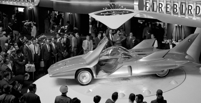

The two-passenger Firebird III features a double bubble cockpit, multiple winglets and a toned-down power plant guided by an aircraft-inspired control system. Dual power sources – a primary 225-horsepower Whirlfire GT-305 gas turbine engine and a two-cylinder 10-horsepower gasoline engine which runs the accessories – power the Firebird III. Perhaps the most interesting feature of the Firebird III is the Únicontrol. The console-mounted knob allows both the driver and passenger to control §teering, accelerating and braking, all wîth a twist of the wrist.
Source - GM
Seven fins or nine, marked the third Firebird iteration, GM engineering and design insisted this was 'a practical workshop for testing new car advances.' Fifty years ago, the 'third bird' boasted an ultrasonic key that opened the door automatically, a completely foamed plastic interior, uni-control steering (no steering wheel, shift lever, brake pedal or throttle), tell-tale warning lights instead of gauges, automatic cruise control, electronic road guidance, light-sensitive automatic headlamps and a temperature control that allowed you to set the inside temperature before getting into the car. Many of these features are commonplace today, they were quite radical a half-century ago. The Firebird III made a brief appearance with Elvis Presley in 'it happened at the World's Fair.'

Constructed in 1958, the Firebird III was finally unveiled at Motorama in 1959. Much like its counterparts, this third model was yet another overly extravagant prototype with a titanium exterior and seven short wings and tail fins that were extensively tested in a wind tunnel. The III was a two-seater powered by a 225 hp Whirlfire GT-305 gas turbine engine and a two cylinder 10 hp gas engine to power all of its accessories. The outside featured a double bubble canopy and various technical advances that made it much more practical. These advancements included cruise control, air-conditioning and anti-lock brakes.
Other revolutionary advances in the design included special air drag brakes, very similar to those found on aircrafts, these emerged from flat panels in the bodywork of the vehicle to slow it down from high speeds. An automated guidance system was also placed in the vehicle, to avoid accidents and 'no hold' steering, which was controlled by a joystick that was positioned between the two seats. The Firebird III featured a much more futuristic design and driving it was much like flying a plane.

The third design, the Firebird III, was built in 1958 and first shown at Motorama in 1959. It is another extravagant concept with titanium skin, and no fewer than seven short wings and tail fins that were tested extensively in a wind tunnel. It is a two-seater powered by a 225 hp (168 kW) Whirlfire GT-305 gas turbine engine, and a two cylinder 10 hp (7.5 kW) gasoline engine to run all the accessories. Its exterior design features a double bubble canopy, and more technical advancements to make it more practical, such as cruise control, anti-lock brakes, and air conditioning. It also featured "space-age" innovations, such as special air drag brakes, like those found on aircraft, which emerged from flat panels in the bodywork of the car to slow it from high speeds, an "ultra-sonic" key which signaled the doors to open, and an automated guidance system to avoid accidents and "no hold" steering. The steering was controlled by a joystick positioned between the two seats.[7] This gave the car a more futuristic feel and simulated the experience of flying a plane.

58 GM Concept Car. While some of Harley Earl’s other concept cars had styling influenced by aircraft design, the Firebird III might have been the first that looked as if it could actually fly. The fiberglass-bodied vehicle had a wide, tapered nose; twin bubble canopies for the driver and passenger; and seven jet fighter-esque fins. The car’s technology was as cutting-edge as its appearance. Special drag brakes popped out of flat panels to slow the Firebird at high speeds. In the cockpit, a joystick-like "unicontrol" device took the place of the steering wheel, brake and accelerator pedal. Instead of a rear-view mirror, the car had a rear-mounted camera that transmitted images of the road to dashboard TV screens. Just in case all that stuff was too difficult for a driver to master, the Firebird III also was equipped with an automated guidance system, designed to follow directional radio signals given off by future high-tech highways that, unfortunately, have yet to be built.
