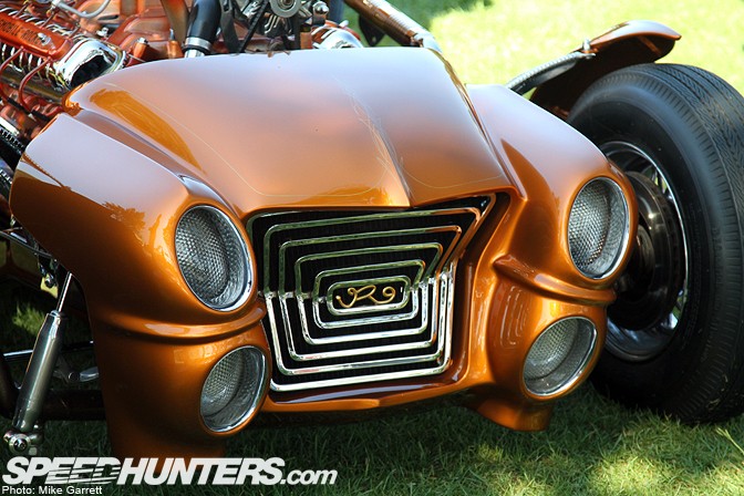

In this form, "Rod"riguez was featured in the February 2003 issue of Cruisin', a Japanese hot rod and custom magazine. Junichi still had more ideas, and tore "Rod"riguez down for a redo. The top was chopped in a unique wedge fashion.
The rear of the top was left at stock height, but the A- and B-pillars were cut four and two inches, respectively, to bring the top down at a rakish new angle. The original grille insert was replaced with a new one fabricated from square tubing, complete with a stylized gold "R" in the center.
Junichi also added wildly sculpted fenders, crafted in metal. Spiderweb-shaped supports were fashioned from chromed rebar rod to hold the forward sections in place. Cragar Star Wire wheels with bullet center caps were mounted on '60s-style whitewall tires.

Junichi is a huge fan of builders like George Barris and Ed Roth, and their legendary show car influence is clear in this build. Look at the custom-formed grill for example, which uses ’59 Cadillac running lights.
