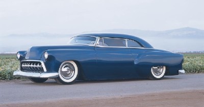

Foster's chopped 1954 Chevy hardtop was the first custom that brought him national acclaim. He pulled the car out of a Northern California junkyard in 1988, then worked on it off and on over the next six years as time and finances permitted.
The chassis was updated with late-model components for reliable cruising. The stock stovebolt six was replaced with a Chevy 350-cid V-8 hooked to a Turbo 350 transmission. A late-model independent front suspension was installed, and the rear suspension was swapped for a '64 Chevy axle on de-arched springs.
The frame was altered for clearance and the gas tank raised to allow for the lower stance. Hubcaps from a 1951 DeSoto were modified with bullet center caps.
Foster chopped the top four inches, replacing the entire rear portion of the roof with custom-rolled sheetmetal by Don Fretwell. The new shape eliminated the factory "dog-leg" rear pillar design in favor of an unbroken tapered slope. The stock "wraparound" rear window was replaced with smaller unit from a 1950 Plymouth.
1954 Chevrolet - Cole Foster Cole-f12
A top chop is a difficult and incredibly important modification for a custom because it dictates the vehicle's overall profile. Foster got this one right.
Foster welded the stock two-piece hood into one piece. He reshaped the grille opening by fashioning a U-shaped grille surround from two 1954 Chevy pieces, cutting down the stock '54 Chevy grille bar to fit within the new opening. In the process, Foster removed the parking-light pods from the grille bar and added four extra teeth. The front gravel pan was molded in and a stock front bumper was mounted in a lower position after its bumper guards were removed.

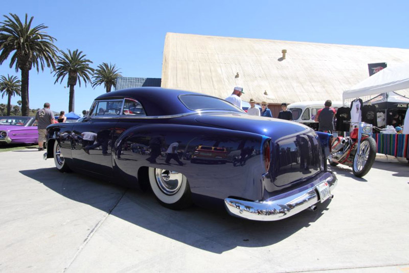

Out back, the stock­ taillights were frenched and bubble lenses from Gene Winfield were added. To match the front, the rear gravel pan was molded in and the rear bumper mounted in a lower position. Note also that the license plate was curved to match the shape of the rear bumper.
The car spent some time in bare metal, then primer, and satin-purple pearl as the work progressed. It was eventually finished with a deep midnight-blue pearl paint job by Jesse Cruz. Later, Mark Dublia applied subtle scallop accents above the head- and taillights.

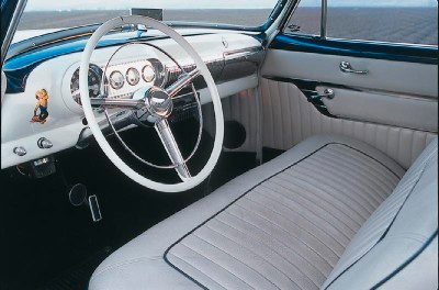

The interior received pearl-white tuck-and-roll upholstery with blue piping. The steering wheel came from a '53 Mercury, and the dash was smoothed and fit with aftermarket gauges in an engine-turned panel next to the factory speedometer.
1954 Chevrolet - Cole Foster Cole-f15
The interior was finished with pearl-white tuck-and-roll upholstery with blue piping.
