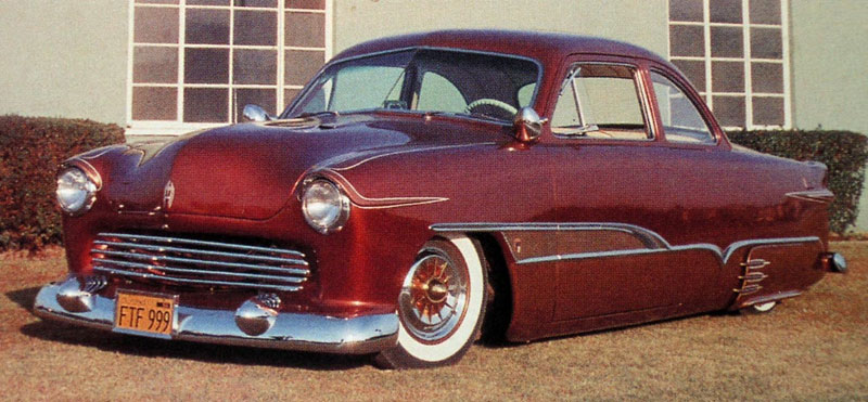

1950 Ford restyled by Hersh "Junior" Conway of Compton, California. Due to wrong information in old magazines the car has for many years been referred to as a 1949 Ford. Through research done by Jerry Daman while he cloned the car, Junior told Jerry that the car was actually a 1950 Ford and not a 1949 Ford. [1]
It was Junior's older brother Herb Conway that first bought the car in January of 1953.[2] After Herb and Junior had restyled Herb's first car, a 1941 Ford Coupe, Herb was urging for a new car. Junior and herb used to cruise around used car lots looking for a possible trade. One day they came across a 1950 Ford Coupe that they liked, and a trade was made. The car they found was mildly customized and repainted gold. The car had primer on the reworked areas which included a shaved 1951 Ford hood, a straight grille bar, and a new molded front gravel shield. The car was also lowered, and had been fit with a Gaylord headliner. Back home, Herb, Hersh, and their dad welded up the deck lid, installed dual Appleton spotlights, and shaved away the door handles. All of this was done with a blow torch. During Herb's ownership Junior paid for the interior to be finished, and Russ & Bess in Compton did the rest of the interior for Herb. Junior bought the car from Herb while he was attending high school. After school he worked at Barris Kustoms, and got guidance and assistance during the build from the guys at the shop. It was his buddy Dick "Peep" Jackson that got Junior a job at Barris Kustoms. In addition to the treatments above, Junior's first version of the car did also feature frenched 1951 Ford taillights.[1]
After being involved in an accident, Junior restyled the car into the Teardrop version. The Teardrop version was a lot more radical then the first version. The second version of the car was modified with later model type finned fenders with 1955 Buick taillights. Fake back up lights were made from white lexan with beveled clear lenses. Junior fit the car with an unique side-trim made from two sets of 1955 Ford Fairlane 2 door side trim pieces fit with gold perforated mesh. The upper spears of the side trim was from a 1954 Dodge. The car did also receive 1950 Mercury fender skirts that were fit with three 24-karat gold plated teeth forming functional airscoops. The teeth were 1/4 inch round rods frenched into the rear panels. Doors, deck and hood were shaved and operated by electrical pushbuttons. 1949-1950 Ford glove box door locks were integrated into the side trim in order to open the shaved doors. Up front the car featured headlight shades built from California Custom Accessories, items available for any car. The headlight shades were fit 1955 Chevrolet headlight rims that were drilled and used as airscoops for the front wheels and brakes. George Barris did also cut twin air scoops half-way back on the hood of the car. The hood corners were rounded and fit to the curves in the 1949 Mercury grille shell. Horizontally positioned 3/4 inch round steel bars were used to fabricate a grille for the car. Junior originally planned to fit the car with a 1954 Pontiac grille bar, but decided to make his own floating grille instead in order to give the car a new and modern look. Bill Carr and George Barris helped out with the engineering and the installation of the grille. A perforated mesh grille was placed behind the outer grille. The bumpers were reshaped 1951 Chevrolet units, cut to fit 1953 Mercury bumper bullets. Junior welded the bullets to the bumpers. The chrome would not stay where the welds were, so Junior had to rechrome the bumper three times while he owned the car. The front gravel shield on the car was molded to the body when Herb first bought it, and the rear gravel was originally intended to be molded to the body too, but due to the crush to get the car ready for a show in late 1956, Junior decided to skip this modification.[1]
The interior was upholstered by Jack's Top Shop who also did the matching upholstery in the trunk. The interior of the car did also feature a radio-telephone. If you look on the color interior shot of the car you will see a chromed heater placed at the passenger side of the car. This heater was in one story about the car described as being a TV set, a fact that is not true. The steering wheel was a 1955 Mercury accessory steering wheel.[1]
The car was lowered up front by installing dropped spindles and cutting the coils. The frame was also modified where the A arms attached. In the rear the springs were de-arched, and 4" blocks were installed. The body was painted in a two tone Rustic metallic lacquer with scallops applied by Dean Jeffries. This version of the car did also have a little pinstriping. More pinstriping and functional chromed lake pipes were added later. This version of the car rolled on a set of candy painted custom hubcaps. After a while, Junior also installed new fender skirts from a 1957 Mercury Turnpike Cruiser on the car, and painted it gold on the sides under the lower side-moldings. After showing the car like this for a while, the custom hubcaps were replaced by chromed and reversed wheels, and Junior installed rippled non-functional lake pipes. This version is the last version of the car while Junior owned it. In 2010 while Jerry Daman was working on re-creating the car he asked Junior what his favorite version was, and he told him that it was "the last one".[1] In 1959, Junior's Shoebox appeared in the movie the T-Bird Gang.
