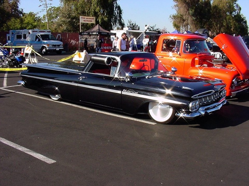

59 CHEVROLET ELCAMINO CUSTOM KUSTOM CHOPPED CHANNELED
Message  Predicta le Jeu 24 Juil - 4:17
Let me start by saying that if you are truly interested you should call GARY MEYERS. He's the builder and will be able to give you the most info about it. I'll give you a description of it from a fans perspective based on what I know from what I have learned from Gary. He started with the frame from a 69 chevelle wagon and then channeled the 59 elcamino down over it two inches which gave it a great stance and a comfortable ride. The whole car has been hand fabricated and not one panel was left untouched.. From the 2 and 3/4 inch chopped top with the dual frenched antennas on both sides to the pancaked hood and custom flip up side view mirror. Everywhere you look you will find subtle changes that made a dramatic change to the original body. Check out the custom fabbed headlight enclosures and custom fabbed taillight enclosures. Very COOL !!! Both the front and rear bumpers have been custom made from very thick plate and then chromed to be functional. Both the front and the rear of the car feature custom made roll pans that add to the clean flowing lines of the car. Look closer and you'll see the custom made bed enclosure that utilizes the roof skin from a van. Underneath that is the gas tank and ample storage for your luggage that you access from behind the custom seats. There's a lot to see on the outside so take your time and look at the pics closer. The more you look the more you'll see. The car has a great stance and an AWESOME PROFILE. Moving to the inside you will see that everything there is custom as well. The console is handformed steel that rolls around into seat enclosures. The console has a retractable cover and houses the shifter and other controls which leave the dash with a very clean and flowing look. You'll be riding in comfort thanks to the vintage heat and a/c unit that Gary installed. This is a driver and with that in mind Gary installed a 454 backed by a turbo 400 that moves the elcamino effortlessly down the road. It's rollin' on Diamondback whitewall radials and torque thrust wheels. everything is topped off with a custom R&M deep purple paint job with an awesome gold accent color
