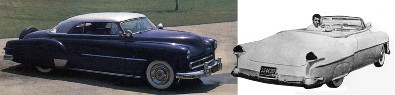

Inspiration for Sam’s 1952 Chevy custom came from many 1950’s restyled Chevy’s, but two of those stood out and became the main inspiration for the Lone Star Deluxe. The Barris created Larry Ernst Hard-Top and the Leon Welmas convertible. Both subtle yet well designed classic customs.
What Sam liked so much about these two classic Chevy Customs was that both had major body modifications, yet both were still very subtle in their overall appearance. That was exactly what Sam had in mind for his own Custom. The end result he was looking for would be subtle, something that would not “Stand Out” in the car show per say. He was rather looking for a car that people would pass, and then turn back to see why this car was looking so good. Then realizing all the details and delicate body modifications that were done to the car to create the “just right” effect. Before Sam actually started to work on his car he discussed all options with his friends, making sure he would make the right decisions in the the style and feel he was looking for.
