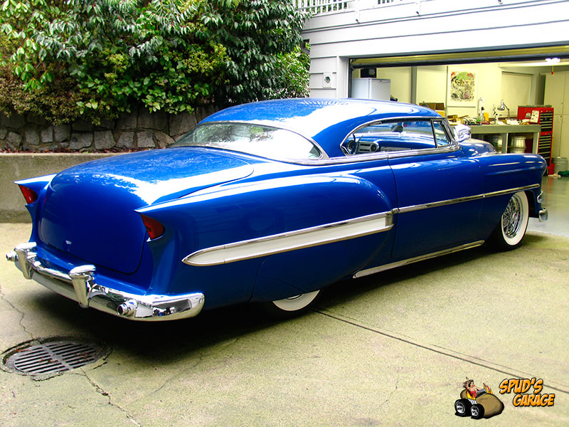

Body Modifications:
• Roof Chop 3.5 inches
• All window frames and windwings chopped and fitted with precision
• Hood is made into one piece with the tip removed on the underside for show like the top
• Hood is nosed and decked
• Headlights are 1953 Ford frenched in with a peak to match the fender line.
• Upper grille bar is frenched into body
• Trunk is blanked out
• Door Handles are shaved
• Rock guards eliminated
• Gas gate was eliminated
• Totally custom made skirts
• Taillights are custom made housingswith 1956 Chrysler inverted lenses
• Grille is a total of 125 teeth
• Front bumper – One piece California filled and shaved, with bumper bolts eliminated
• Rear bumper – One piece California extended 3 inches on each side with two port holes for exhaust frenched in.
• ’56 Chev front bumper-ettes using ’57 Cadillac bridge and frenched in to create a spectator looking bumper.
• Rear deck at rear window was widened and cribbed to stock to move the window forward for a correct roof line like stock.

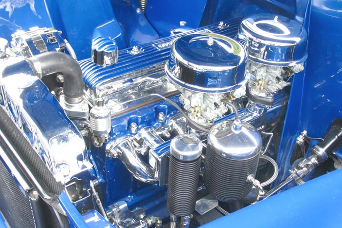

Drive Train
1959 – 261 cu. in. Chevy inline 6 cylinder (new Rebuild)
Internal Specs
• Balanced and Blueprinted
• Jans Aluminum pistons
• Torquey cam by Shadbolt – the best in the business
• Stainless steel pushrods
• N.O.S. GM hydraulic lifters
• Factory GM high compression 868 head
Exterior of Mill
• 2 Rochester cards with 1950’s real Hellings and Stellings Card air cleaners (chrome) over brass
• Extreme attention to detail was considered to the custom brackets for mounting the alternator, compressor and power steering pump.
• All accessories are chrome to the highest show quality by Performance Chroming
• Offenhauser valve cover
• Rare Offenhauser side cover
• Offenhauser manifold
• Beehive oil filter (finned)
• Power steering reservoir finned to match oil filter
• Chrome bellhousing
• Chrome coil, chrome alternator, chrome compressor, chrome pulley
• Chrome Fenton headers
• All braided stainless hoses were used on the motor
• Polished stainless hoodsprings
• All custom dual exhaust by Muffler Tech
• Ceramic coated
