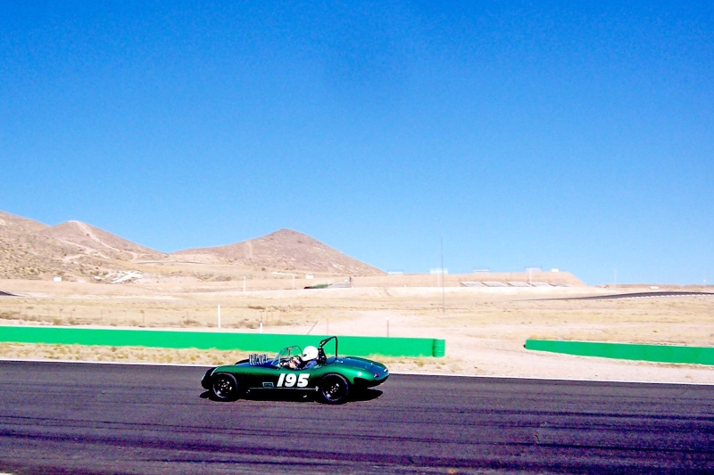

The car in this ad has the unusually rare combination of both speed and beauty. It is a beautiful car to look at and is a beastly fast car to drive. It has an excellent racing history and is running a Chevy 283 that has been bored out to 297 with three two barrel Rochester carbs. The car has been fully setup for vintage racing but could also be set up for street use with the necessary modifications. Note at time of listing we did not know the mileage or if the car even has an odometer.

For any party that would be interested in this car for vintage racing or just pride of ownership in their collection we offer up the current owner’s list of specifications and modifications that have been done to this car to make it what it is. We realize that it is an extremely lengthy list but we also feel that after you read it you will be fully impressed.
