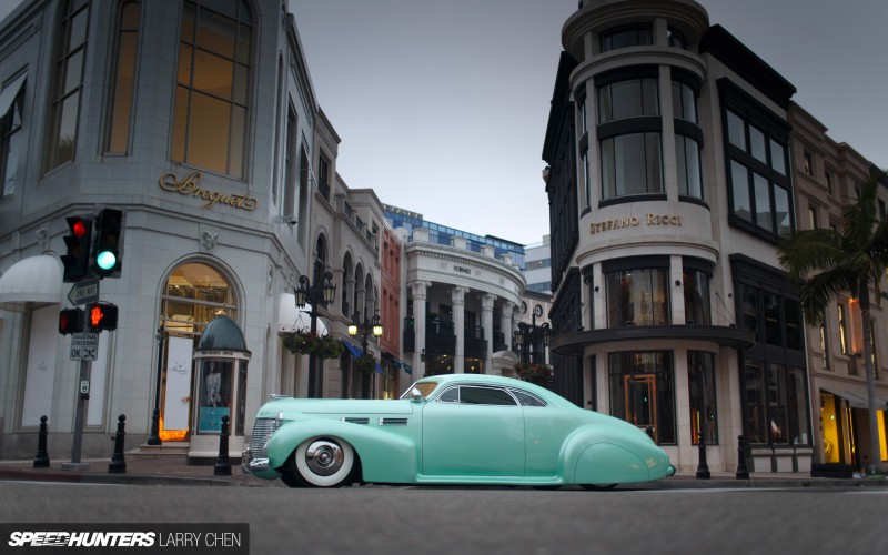

I feel like I know John D’Agostino’s name by osmosis. He’s been in the custom car scene as long as I can remember and I’ve seen his name in print more times than I can count. But just in case you aren’t familiar, let me put it this way: he’s been building custom rides non-stop since the ’60s and has no intention of letting up. So last year at SEMA when I walked up and saw his name tag I immediately knew who the guy standing in front of me was.
Fortunately my own kustom was nearby, and after a quick ‘nice to meet ya’ I insisted that he come check it out. Not to brag or show off though; I truly wanted the feedback of a legend. As so often happens in the car world we were instant friends, simply by virtue of our vehicular interests.
It’s hard to believe that was only one short year ago. Since then, John and I have crossed paths another half dozen times, no doubt thanks to this Speedhunting gig. A few months ago we were both showing our cars at the Long Beach Motorama and I got the chance to finally hear about his latest creation in his own words: a 1940 Series 62 Cadillac.

This isn’t John’s third or fourth kustom: it’s actually well past number 100, if you can comprehend that. These days John has his fabricator friend Oz Welch do most of the heavy lifting, but he’s there every step of the way making sure that what comes out of the shop is a true D’Agostino kustom. John’s real passion is in the design of the car, and having owned and built so many kustoms it’s safe to say he’s got that part dialed.
So how did John D’Agostino and his buddy Oz build a Caddy that looks so sinister on one hand…
…yet so elegant on the other?
It’s noteworthy that John chose to start with a Series 62 Cadillac coupe, since these cars are far from common. In fact, according to John, there are only eight of them currently registered in the United States! While most builders are chopping Shoebox Fords and Chevys, these guys are sourcing unique iron to use as their starting point. I guess when you’ve built so many cars you have to get creative to find a new one to build.

The roof-line is arguably the most crucial component of a kustom, so let’s start with a look at the top. Anyone can tell it’s chopped, sure, but there are a lot of details here that Johnny was particular about. It’s a sloped chop, five inches in front and six and a half in back, with a form reminiscent of the Matranga Merc. The entire roof skin was sectioned and thinned before new drip rails were made from 3/16-inch steel rod. Taking things one step further, the rear windows are removable so the car can take on the look of a pillarless hardtop with the front windows rolled down.
Personally I love that they kept the dip behind the back window, because it retains the original three-box form. While Oz was reshaping the fender skirts and crafting custom running boards he went ahead and molded every panel together, making the body one complete unit. Gaps only exist where things open and close, like the hood, doors and trunk. This is a bold move should the car ever be damaged, but the smoothness is simply beyond words.
While they were moving metal Oz pushed and pulled some things to amplify the lines of the Cad, like widening the rear fenders two inches per side.
The front fenders were also pushed out an inch, and while the nose of the car might seem stock, things start getting especially tasty when you take a closer look

Along with all the sheetmetal and paint work, Oz also did the chassis modifications. He installed air-ride to allow the frame to sit one inch off the pavement, then lift up to a comfortable ride height.
As you can see, it looks best fully laid out. Those are chromed ’53 Cadillac hubcaps, a departure from the wire wheels D’Agostino kustoms usually wear.
I think the thing that strikes me the most about D’Agostino’s latest kustom is how right it looks. After all, that’s the sign of a great customizer: the ability to make a car look better than it did from the factory.
Equally impressive is John and Oz’s ability to keep coming up with new things to build, and raise the bar each time too. Several people have already remarked that this is the best D’Agostino kustom yet, and with over a hundred D’Agostino kustoms that have already been built, that’s saying something.
Not only has Sophia swept every show she’s attended in her debut year, but right after Larry finished this shoot the car was taken to the Petersen Automotive Museum to be put on display. John tells me he’s working on a ’41 Caddy next that will be be the perfect contrast to the ’40. I have a hard time picturing that, but I’m sure it will blow everyone away once again!
